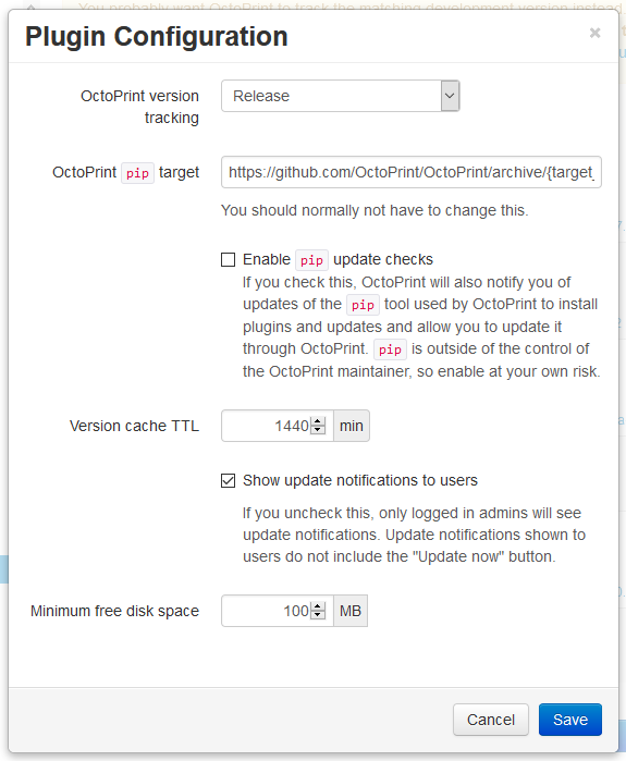

Software Update plugin configuration dialog
Fig. 22 The Software Update plugin configuration dialog
There you can adjust the following settings:
  • OctoPrint version tracking: Whether you want to track OctoPrint releases or every commit. Usually you want to select “Release” here which is also the default, unless you are a developer.
  • Tracked branch (if tracking is set to “Github Commit”): The branch that will be tracked if you set version tracking to “Github Commit”.
  • OctoPrint ``pip`` target (if tracking is set to “Release” or “Github Commit”): The argument that will be provided to pip when updating OctoPrint. Usually you don’t want to change this from its default value of https://github.com/OctoPrint/OctoPrint/archive/{target_version}.zip.
  • OctoPrint checkout folder (if tracking is set to “Local checkout”): This must be the path to OctoPrint’s git checkout folder (/home/pi/OctoPrint for OctoPi or manual installs following the Raspberry Pi setup guide). Note that since OctoPrint 1.3.6 you will no longer need to set this to be able to update to releases, only if you want to be able to update against some bleeding edge git branch.
  • Enable ``pip`` update checks: Whether to have OctoPrint automatically check for updates of the pip tool that is used for updating most components.
  • Version cache TTL: The “time to live” of the cache OctoPrint will use to temporarily persist the version information for the various components registered with the plugin, so that they don’t have to be queried from the internet every time you load the page. Defaults to 24h, you usually shouldn’t need to change that value.
  • Show notifications to users: Whether to display update notifications (without “Update now” button) to users that cannot apply updates.
  • Minimum free disk space: The minimum amount of free disk space needed in order to allow software updates to be run.
More settings are available by editing the corresponding section in config.yaml.
