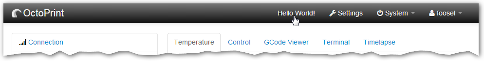

Frontend fun: How to add functionality to OctoPrint’s web interface
Outputting a log line upon server startup is all nice and well, but we want to greet not only the administrator of our OctoPrint instance but actually everyone that opens OctoPrint in their browser. Therefore, we need to modify OctoPrint’s web interface itself.
We can do this using the TemplatePlugin mixin. For now, let’s start with a little “Hello World!” in OctoPrint’s
navigation bar right at the top that links to the Wikipedia node about “Hello World” programs. For this we’ll first
add the TemplatePlugin to our HelloWorldPlugin class:
import octoprint.plugin
class HelloWorldPlugin(octoprint.plugin.StartupPlugin,
                       octoprint.plugin.TemplatePlugin):
    def on_after_startup(self):
        self._logger.info("Hello World!")
__plugin_name__ = "Hello World"
__plugin_pythoncompat__ = ">=3.7,<4"
__plugin_implementation__ = HelloWorldPlugin()
Next, we’ll create a sub folder templates underneath our octoprint_helloworld folder, and within that a file
helloworld_navbar.jinja2 like so:
<a href="https://en.wikipedia.org/wiki/Hello_world">Hello World!</a>

Restart OctoPrint and open the web interface in your browser (make sure to clear your browser’s cache!).
Now look at that!

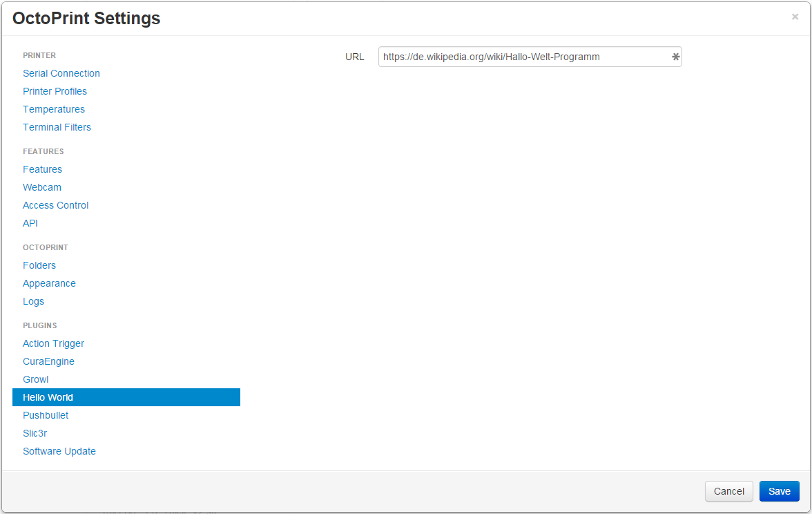

First of all, we’ll create the settings dialog. You might already have guessed that we’ll need another template for that.
So in your plugin’s templates folder create a new file helloworld_settings.jinja2 and put the following content
into it:
<form class="form-horizontal">
    <div class="control-group">
        <label class="control-label">{{ _('URL') }}</label>
        <div class="controls">
            <input type="text" class="input-block-level" data-bind="value: settings.plugins.helloworld.url">
        </div>
    </div>
</form>
Note how we access our plugin’s property via settings.plugins.helloworld.url. The settings observable is made
available in the SettingsViewModel and holds the exact data structure returned from the server for all of
OctoPrint’s settings. Accessing plugin settings hence works by following the path under which they are stored in
OctoPrint’s internal settings data model (made public via the config.yaml), plugins.<plugin identifier>.<configuration key>.
We’ll bind our own settings dialog to the existing SettingsViewModel, so this will be the way we’ll access our

Restart OctoPrint and shift-reload your browser. Your link in the navigation bar should still point to the URL we
defined in config.yaml earlier. Open the “Settings” and click on the new “Hello World” entry that shows up under
“Plugins”.
Nice! Edit the value, then click “Save”. Your link in the navigation bar should now have been updated as well.
The way we’ve done our data binding and how OctoPrint currently works, your link’s target will update immediately when you update the value in the settings dialog. Even if you click Cancel instead of Save, the change will still be reflected in the UI but will be overwritten again by the stored data upon a reload. This is caused by OctoPrint not storing a copy of the settings data while it is being edited, which might be changed in the future to prevent this unexpected behaviour from occurring.
Congratulations, you’ve just made your Plugin configurable :)

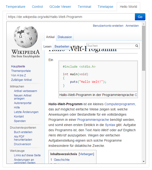

More frontend fun: Adding custom javascript to your frontend components
In the previous section we set that custom_bindings parameter to False since we wanted OctoPrint to bind the
SettingsViewModel to our settings dialog and the NavigationViewModel to our entry in the nav bar.
But what if we want to define our own, with more functionality that is already available? Let’s take a look. We’ll now add an additional UI component to our OctoPrint interface, a custom tab. It will act as a little internal web browser, showing the website behind the URL from the settings in an IFrame but also allowing the user to load a different URL without having to change the settings.
First let us create the Jinja2 template for our tab. In your plugin’s templates folder create a new file
helloworld_tab.jinja2 like so:
<div class="input-append">
    <input type="text" class="input-xxlarge" data-bind="value: newUrl">
    <button class="btn btn-primary" data-bind="click: goToUrl">{{ _('Go') }}</button>
</div>
<iframe data-bind="attr: {src: currentUrl}" style="width: 100%; height: 600px; border: 1px solid #808080"></iframe>
Then we create a new folder in your plugin’s root called static and within that folder another folder by the name of
js. Finally, within that folder create a file helloworld.js. Our plugin’s folder structure should now
look like this:

Our view model defines two observables: newUrl, which we bound to the input field in our template, and currentUrl
which we bound to the src attribute of the “browser iframe” in our template. There’s also a function goToUrl
which we bound to the click event of the “Go” button in our template.
Restart OctoPrint and shift-reload the browser. You should see a shiny new “Hello World” tab right at the end of the tab bar. Click on it!
The desktop version of that article looks a bit squished in there, so let’s enter https://de.m.wikipedia.org/wiki/Hallo-Welt-Programm
into the input field and click the “Go” button. The page inside the iframe should be replaced with the mobile version
of the same article.
