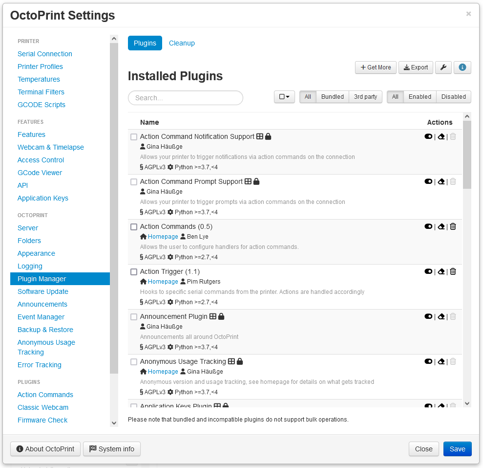

Fig. 19 The main dialog of the Plugin Manager

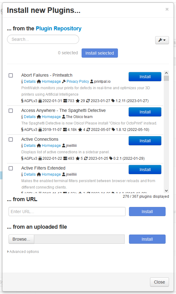

Fig. 20 Dialog for installing new plugins

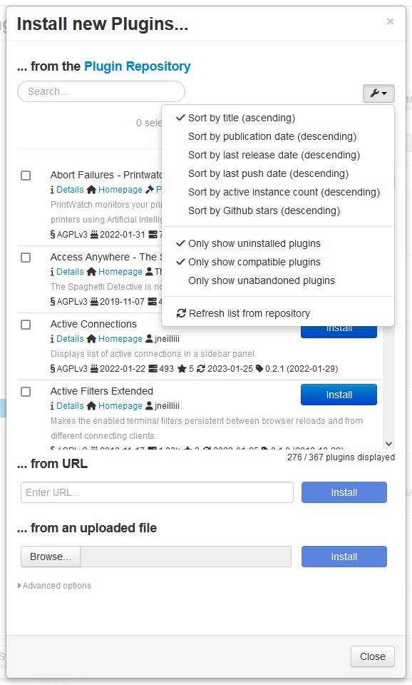

Fig. 21 Filter options for the repository browser
