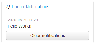

Fig. 5 A simple notification example triggered by the firmware¶

Example communication with the firmware¶
To display the above notification the firmware sent this action command:
//action:notification Hello World!
