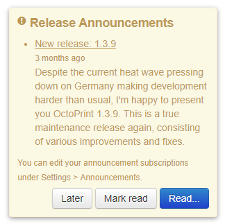

Fig. 8 An example notification from the Announcement Plugin.¶

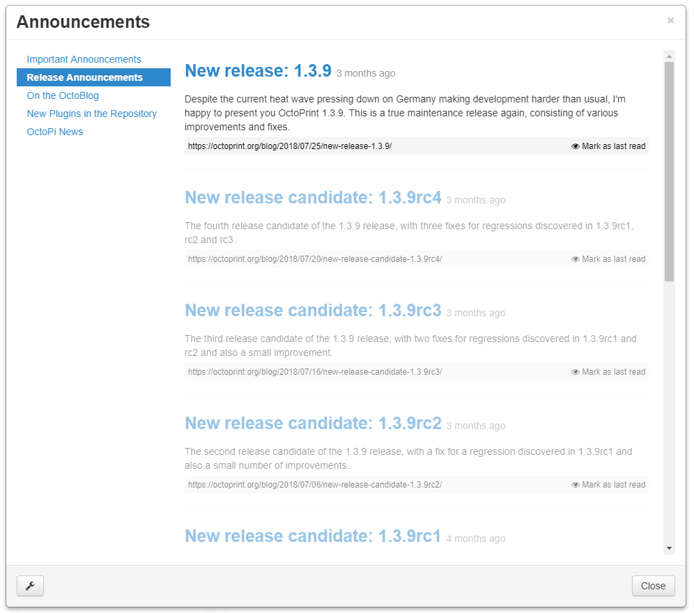

Fig. 9 The Announcement Plugin’s reader dialog.¶

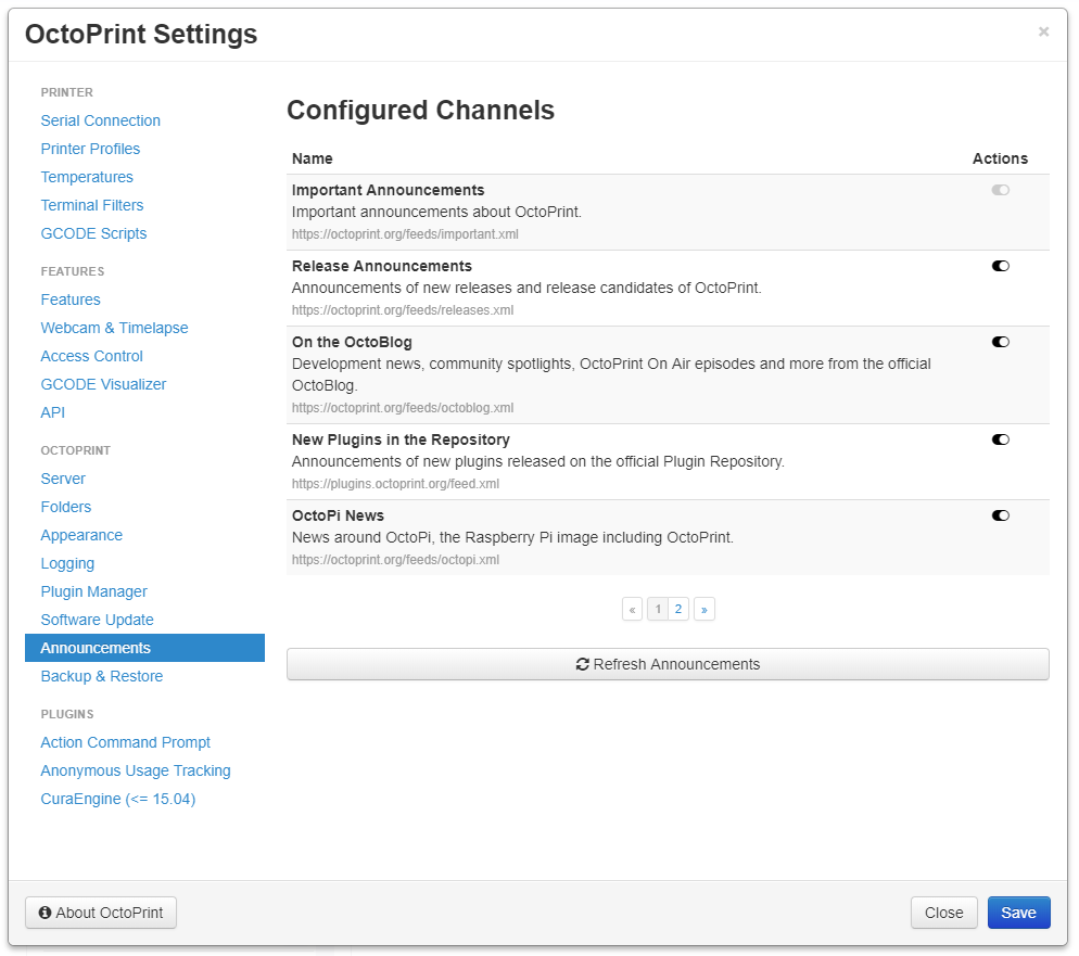

Fig. 10 The Announcement Plugin’s settings dialog.¶
Configuring the plugin¶
The plugin allows enabling and disabling the preconfigured announcement channels via its settings dialog.
On top of that it’s possible to add additional announcement channels (as RSS or Atom feed URLs) or change the
configuration of the existing channels through config.yaml.
The available configuration keys are:
channels: Configured announcement channels. A mapping from a unique identifier to a configuration structurethat follows this format:
name: Name of the channel, used e.g. in the title of the displayed notifications.description: Description of the channel.priority:1for high priority announcements (red notification),2for regular ones (yellow notification).type: Currently unused.url: URL for the feed acting as notification source, must be RSS or Atom format.
enabled_channels: List of identifiers of enabled channels.forced_channels: List of identifiers of channels that cannot be disabled (currently only_importantwhich is used sparingly).channel_order: List of channel identifiers in the order they should appear in the UI.ttl: Time to live of the channel cache in minutes (default: 6 hours).display_limit: Limit of items to display per channel (default: 3).summary_limit: Limit of characters to display from each channel entry (default: 300).
