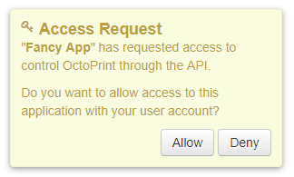

Fig. 11 The plugin’s confirmation generated for a new application key request.

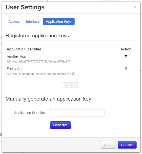

Fig. 12 Users can manage the application specific API keys registered to their account via their user settings.

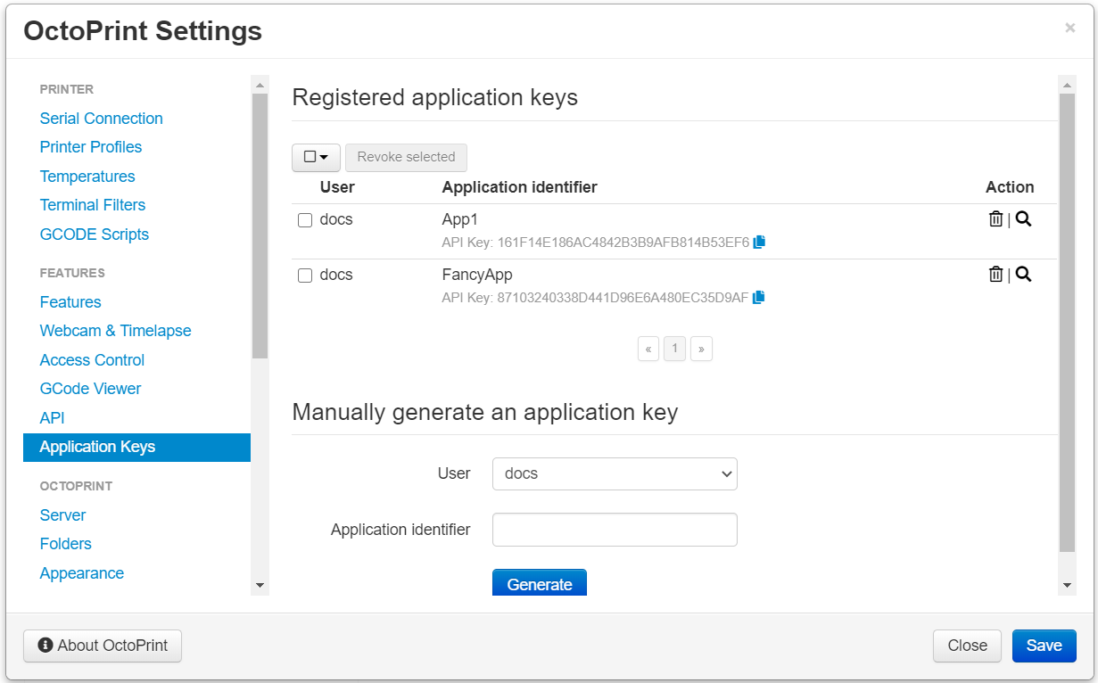

Fig. 13 Administrators can manage all application specific API keys registered to any user.

The Server triggers a confirmation dialog for the User on the Webinterface (unused here) and returns an endpoint to the App to poll for a decision in the
Locationheader of an HTTP 201 Created and an Authorization response (unused here).The App uses the obtained request specific endpoint to poll for a decision every second. An HTTP 202 Accepted signals that no decision has been made yet.
The User either accepts or denies the access request which makes the Webinterface send a decision request to the Server.
If the User accepted the request, the App receives an HTTP 200 OK with an attached API key response. If they deny it, the App will receive an HTTP 404 Not Found.
