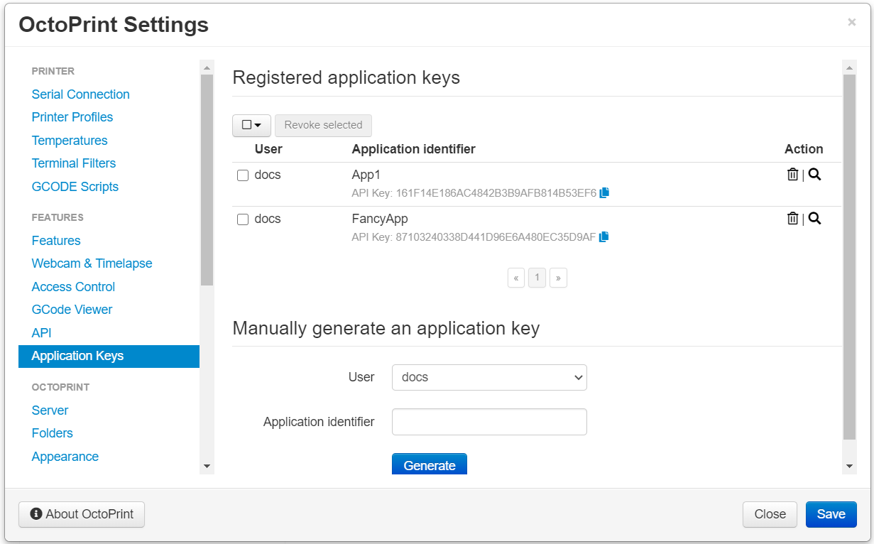

Fig. 11 The plugin’s confirmation generated for a new application key request.¶
Fig. 12 Users can manage the application specific API keys registered to their account via their user settings.¶
Fig. 13 Administrators can manage all application specific API keys registered to any user.¶
