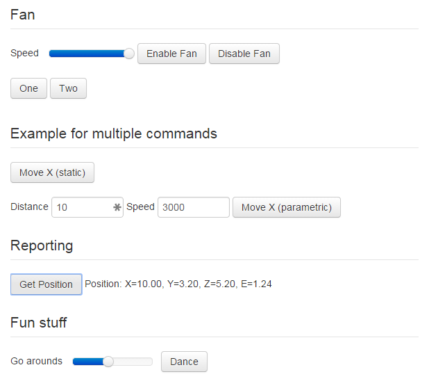

Adding this to config.yaml, restarting the OctoPrint server and switching to the “Control” tab within its interface yields the visual representation in Fig. 1.
The rendered output created through the example configuration
Fig. 1 The rendered output created through the example configuration

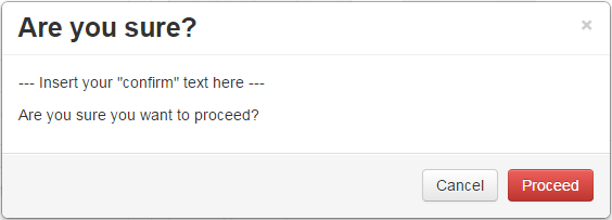

confirm
(Optional) A text to display to the user to confirm his button press. Can be used with sensitive custom controls like changing EEPROM values in order to prevent accidental clicks. The text will be displayed in a confirmation dialog like in Fig. 2.
regex and template are only supported for controls that are defined through config.yaml. These control properties aren’t supported for controls added only in the frontend by the getAdditionalControls view model callback.
An example confirmation dialog
Fig. 2 An example confirmation dialog
