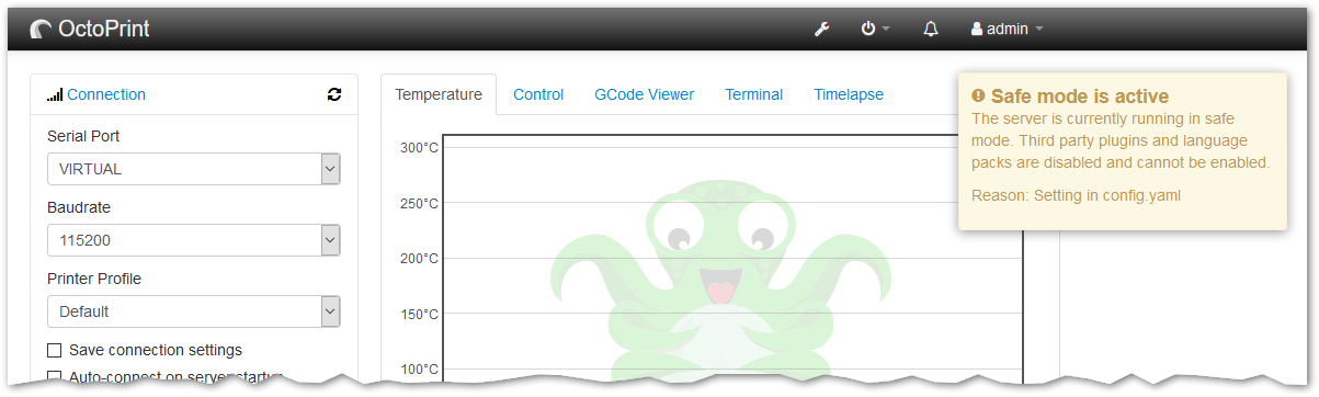

OctoPrint’s web interface will display a notification to remind you that it is running in safe mode.
Fig. 4 Safe mode notification¶
