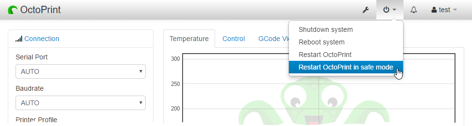

by selecting “Restart OctoPrint in safe mode” from the “System” menu, if the “Restart OctoPrint” server command has been correctly configured (since OctoPrint 1.3.2, see Fig. 3)

Fig. 3 “Restart OctoPrint in safe mode” in the “System” menu

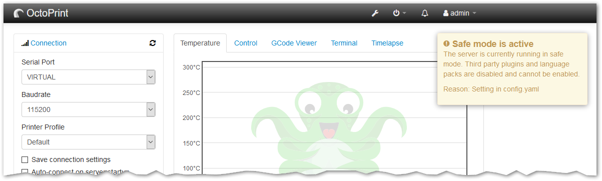

OctoPrint’s web interface will display a notification to remind you that it is running in safe mode.
Fig. 4 Safe mode notification
