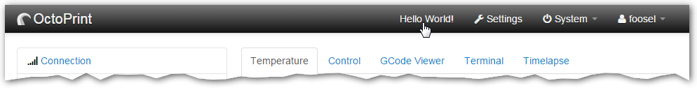

Restart OctoPrint and open the web interface in your browser (make sure to clear your browser’s cache!).
Our "Hello World" navigation bar element in action
Now look at that!

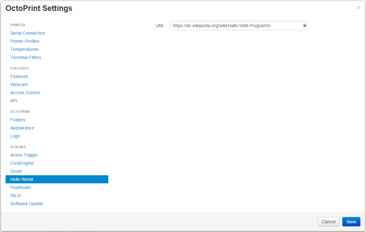

First of all, we’ll create the settings dialog. You might already have guessed that we’ll need another template for that. So in your plugin’s templates folder create a new file helloworld_settings.jinja2 and put the following content into it:
<form class="form-horizontal">
    <div class="control-group">
        <label class="control-label">{{ _('URL') }}</label>
        <div class="controls">
            <input type="text" class="input-block-level" data-bind="value: settings.plugins.helloworld.url">
        </div>
    </div>
</form>
Note how we access our plugin’s property via settings.plugins.helloworld.url. The settings observable is made available in the SettingsViewModel and holds the exact data structure returned from the server for all of OctoPrint’s settings. Accessing plugin settings hence works by following the path under which they are stored in OctoPrint’s internal settings data model (made public via the config.yaml), plugins.<plugin identifier>.<configuration key>. We’ll bind our own settings dialog to the existing SettingsViewModel, so this will be the way we’ll access our property.

If you were now to restart OctoPrint and reload the web interface, you’ll get the settings dialog placed just fine in OctoPrint’s settings, and the link would also still show up in the navigation bar, but both the input field of the settings dialog as well as the link’s href attribute would not show our link. The reason for this is that OctoPrint by default assumes that you’ll want to bind your own view models to your templates and hence “unbinds” the included templates from the templates that are in place at the injected location already. In order to tell OctoPrint to please don’t do this here (since we do want to use both NavigationViewModel and SettingsViewModel), we’ll need to override the default template configuration using the get_template_configs method. We’ll tell OctoPrint to use no custom bindings for both our navbar and our settings plugin. We’ll also remove the override of octoprint.plugin.TemplatePlugin.get_template_vars() again since we don’t use that anymore:

Restart OctoPrint and shift-reload your browser. Your link in the navigation bar should still point to the URL we defined in config.yaml earlier. Open the “Settings” and click on the new “Hello World” entry that shows up under “Plugins”.
Nice! Edit the value, then click “Save”. Your link in the navigation bar should now have been updated as well.

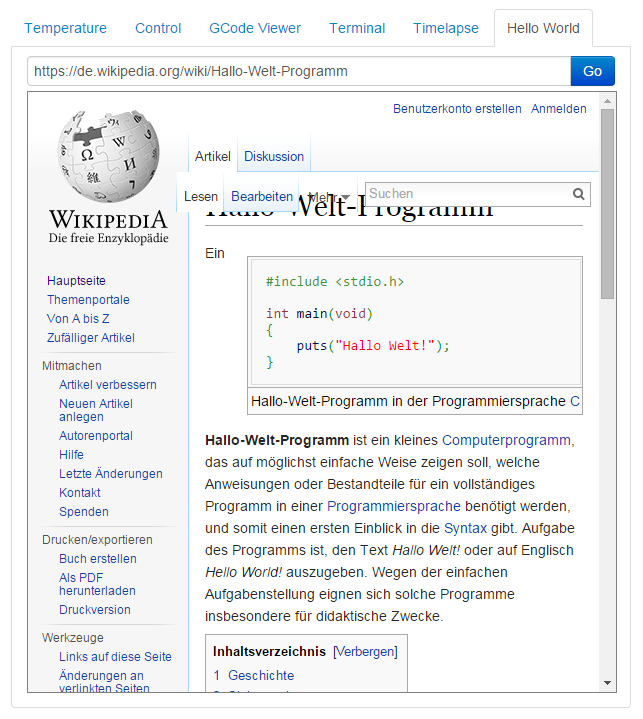

Take a close look at lines 31 to 42. This is how our plugin tells OctoPrint about our new view model, how to instantiate it, which dependencies to inject and to which elements in the final page to bind. Since we want to access the URL from the settings of our plugin, we’ll have OctoPrint inject the SettingsViewModel into our own view model, which is registered within OctoPrint under the name settingsViewModel. We’ll only bind to our custom tab for now, which OctoPrint will make available in a container with the id tab_plugin_helloworld (unless otherwise configured).
Our view model defines two observables: newUrl, which we bound to the input field in our template, and currentUrl which we bound to the src attribute of the “browser iframe” in our template. There’s also a function goToUrl which we bound to the click event of the “Go” button in our template.
Restart OctoPrint and shift-reload the browser. You should see a shiny new “Hello World” tab right at the end of the tab bar. Click on it!
Our "Hello World" tab in action
The desktop version of that article looks a bit squished in there, so let’s enter https://de.m.wikipedia.org/wiki/Hallo-Welt-Programm into the input field and click the “Go” button. The page inside the iframe should be replaced with the mobile version of the same article.
