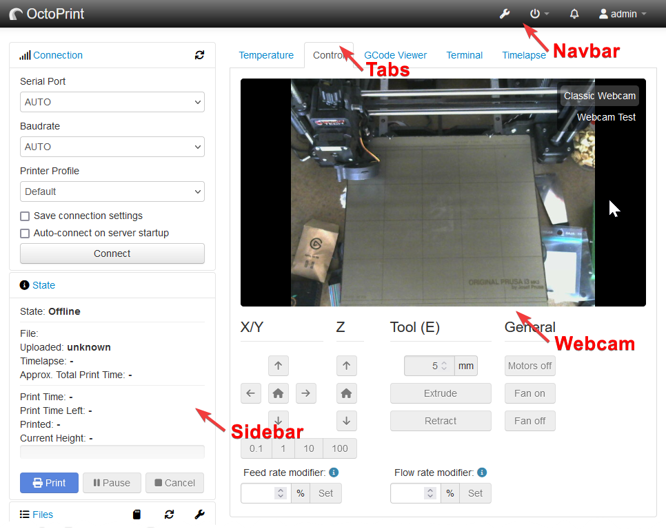

Using the TemplatePlugin mixin plugins may inject their own components into the OctoPrint web interface.
Currently OctoPrint supports the following types of injections out of the box:
Navbar
The right part of the navigation bar located at the top of the UI can be enriched with additional links. Note that with the current implementation, plugins will always be located to the left of the existing links.
The included template must be called <plugin identifier>_navbar.jinja2 (e.g. myplugin_navbar.jinja2) unless overridden by the configuration supplied through get_template_configs().
The template will be already wrapped into the necessary structure, plugins just need to supply the pure content. The wrapper structure will have all additional classes and styles applied as specified via the configuration supplied through get_template_configs().
Sidebar
The left side bar containing Connection, State and Files sections can be enriched with additional sections. Note that with the current implementations, plugins will always be located beneath the existing sections.
The included template must be called <plugin identifier>_sidebar.jinja2 (e.g. myplugin_sidebar.jinja2) unless overridden by the configuration supplied through get_template_configs().
The template will be already wrapped into the necessary structure, plugins just need to supply the pure content. The wrapper divs for both the whole box as well as the content pane will have all additional classes and styles applied as specified via the configuration supplied through get_template_configs().
Tabs
The available tabs of the main part of the interface may be extended with additional tabs originating from within plugins. Note that with the current implementation, plugins will always be located to the right of the existing tabs.
The included template must be called <plugin identifier>_tab.jinja2 (e.g. myplugin_tab.jinja2) unless overridden by the configuration supplied through get_template_configs().
The template will be already wrapped into the necessary structure, plugins just need to supply the pure content. The wrapper div and the link in the navigation will have the additional classes and styles applied as specified via the configuration supplied through get_template_configs().

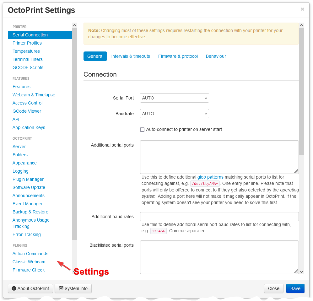

Settings
Plugins may inject a dialog into the existing settings view. Note that with the current implementation, plugins will always be listed beneath the “Plugins” header in the settings link list, ordered alphabetically after their displayed name.
The included template must be called <plugin identifier>_settings.jinja2 (e.g. myplugin_settings.jinja2) unless overridden by the configuration supplied through get_template_configs().
The template will be already wrapped into the necessary structure, plugins just need to supply the pure content. The wrapper div and the link in the navigation will have the additional classes and styles applied as defined via the configuration through get_template_configs().

Template injection types in the main part of the interface
Fig. 27 Template injection types in the main part of the interface
Template injection types in the settings
Fig. 28 Template injection types in the settings

  • sidebar: sidebar heading
  • tab: tab heading
  • settings and usersettings: settings link
  • webcam: selection button
  • wizard: wizard link
  • mfa_login: form heading
  • usersettings_mfa: section heading
  • about: about link
  • generic: unused
