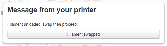

Fig. 6 A simple dialog example triggered by the firmware¶

To display the above dialog the firmware sent these action commands:
//action:prompt_begin Filament unloaded, swap then proceed
//action:prompt_choice Filament swapped
//action:prompt_show
If the user clicks the button, OctoPrint will send back M876 S0 (0-based index).

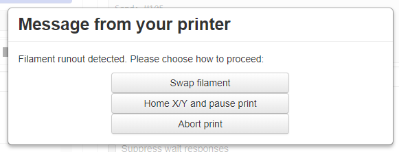

A more complicated example with three options would be the following:
//action:prompt_begin Filament runout detected. Please choose how to proceed:
//action:prompt_choice Swap filament
//action:prompt_choice Home X/Y and pause print
//action:prompt_choice Abort print
This would produce the following output:
Fig. 7 Another dialog example triggered by the firmware¶
If the user selects “Abort print”, OctoPrint will send 2 as selected choice.
