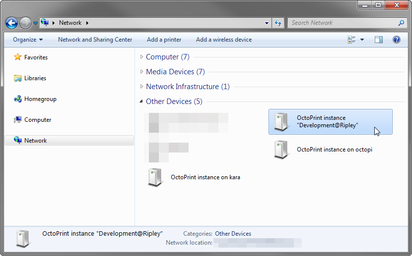

The SSDP/UPNP support allows OctoPrint to announce itself to machines on the same network running Microsoft Windows. You will be able to just double click on the OctoPrint instance icon in “Networks > Other Devices” in your Windows Explorer, which will take you directly to the web frontend.

OctoPrint instances in Windows Explorer
Fig. 16 Various discovered OctoPrint instances in Windows Explorer
