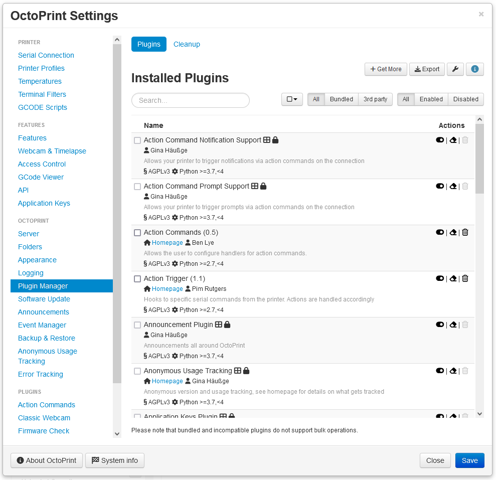

Plugin Manager
Fig. 19 The main dialog of the Plugin Manager

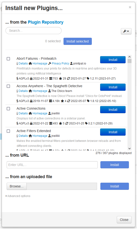

Installation dialog
Fig. 20 Dialog for installing new plugins

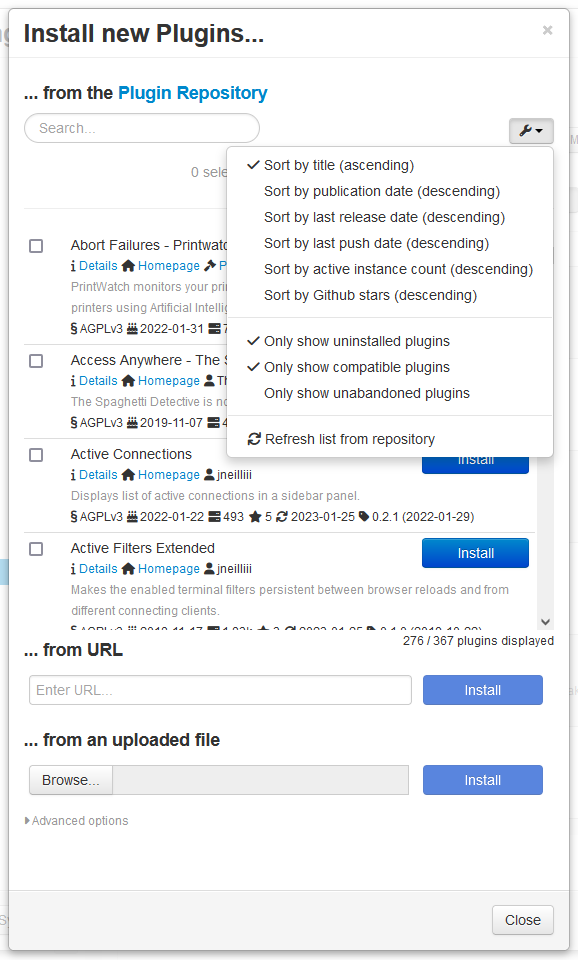

Filter options for the repository browser
Fig. 21 Filter options for the repository browser
