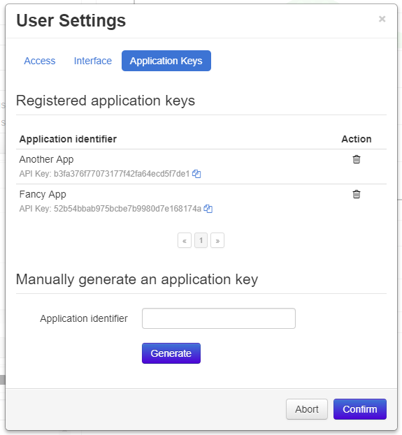

Key management via user settings
Fig. 12 Users can manage the application specific API keys registered to their account via their user settings.

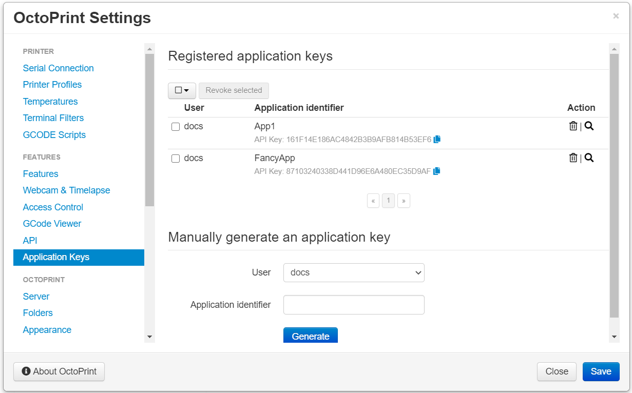

Global key management via settings
Fig. 13 Administrators can manage all application specific API keys registered to any user.
