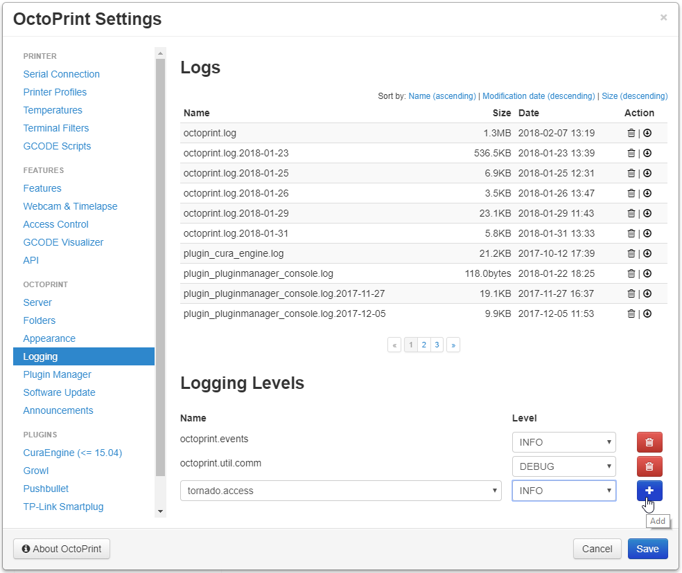

The OctoPrint Logging plugin implements the log management functionality that was formerly part of the core application and adds features to configure logging levels for sub modules through the included settings dialog.
Logging plugin
Fig. 18 The settings dialog of the Logging plugin
