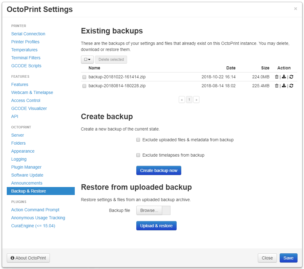

OctoPrint Backup Plugin
Fig. 14 The plugin’s settings panel with existing backups, the backup creation and restore sections.
As long as plugins adhere to the standard of storing their data and settings in OctoPrint’s plugin data folders, their data will be part of the backup. Note that the backups made by the Backup Plugin will not be part of any backups - you’ll need to persist the resulting zip files yourself!
